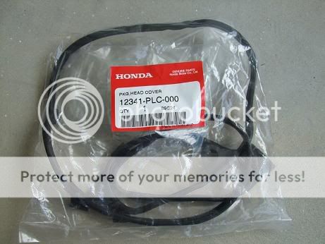

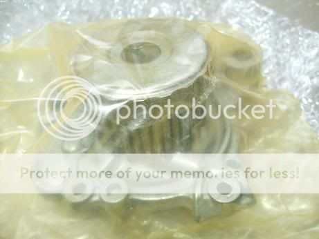

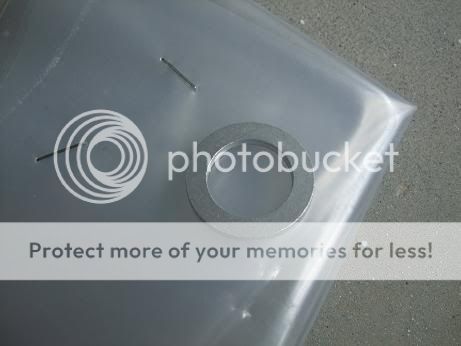

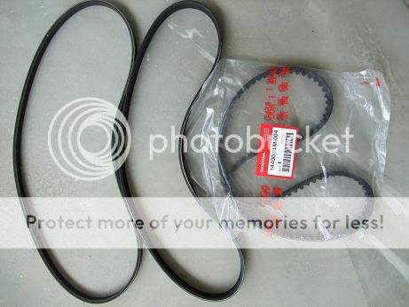

Finally got all the items ready for my 160,000km servicing.
Hopefully, these infor can benefit those Brothers going for the same servicing too.
1) Timing Belt (14400-PLM-014) - S$28
2) Compressor Belt (38920-PLC-003) - S$16
3) Power Steering Belt (56992-PLM-T01) - S$16
4) Timing Bearing (14520-PLC-305) - S$65
5) Washer (94109-14000) - S$1.50
6) Packing, Head Cover (12030-PLC-000) - S$15
7) Seal, Spark Plug Tube (12342-P08-004) - S$4.50 x 4
8 ) Washer Head Cover (90442-REA-Z00) - S$$3.50 x 5
9) Oil Seal Timing (38x50x7) - S$6
10) Oil Seal Camshaft (29x45x8) - S$5
11) Pump Comp, Water (19200-PLM-A01) - S$95
12) Honda Long Life Coolant Type 2 (3.85l) - S$40 (will need 4 to 5litres)
13) Engine Oil 5W40 (Mobil 1 from Carrefour) - S$65
14) Green HAMP Oil Filter - S$8
I don't know any workshops. Had been using Wong from Kah Motors (formerly at Jurong but now at LengKee) even after warranty. He told me it's about S$300 +/- in all. Had made an appointment with him Tuesday.
Will update on the final servicing price later.
Cheers.
